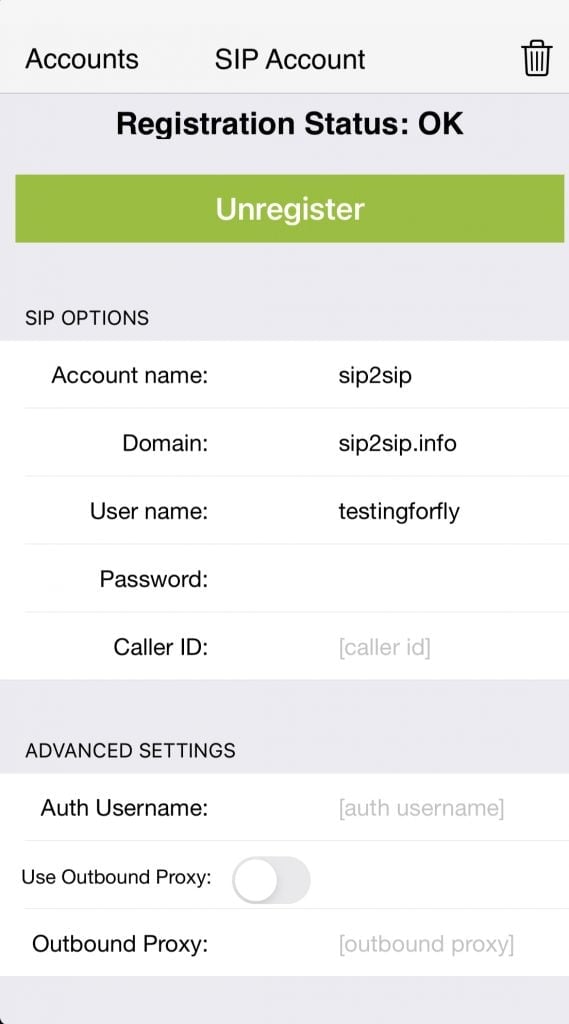

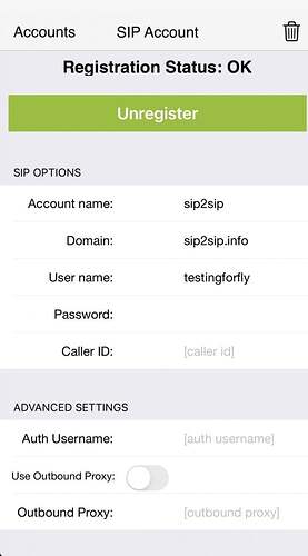

No you can use a solution like this with Zoiper without using the phone system.

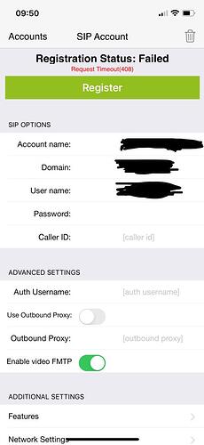

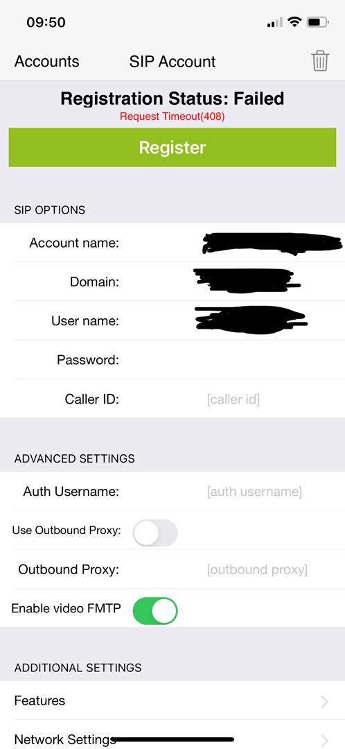

I followed the guide you posted about setting up the Zoiper app and SIP2SIP. While I managed to create an account, I ran into a problem.
In Zoiper networking settings, the registration status will fail if I change Transports to TCP and disable STUN. And if I change Transports back to UDP, the registration status will succeed, however, I won’t be able to make calls.
Screenshot:
Any idea how to get around this issue?
You would want to contact sip2sip in this case as you’re making outgoing calls with them. You can use our phone system for an easy way to make outgoing calls.

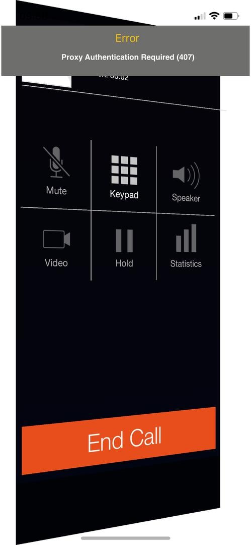

Wait, I just noticed that my prepaid balance in Flynumber is $0.00. Also it turns out that I can now receive incoming calls in Zoiper app, but can’t make any outgoing calls. Does that mean I have add money a prepaid balance to Flynumber?
Prepaid is 0 as the funds you added (2.95 USD) went towards your first month on the number.
