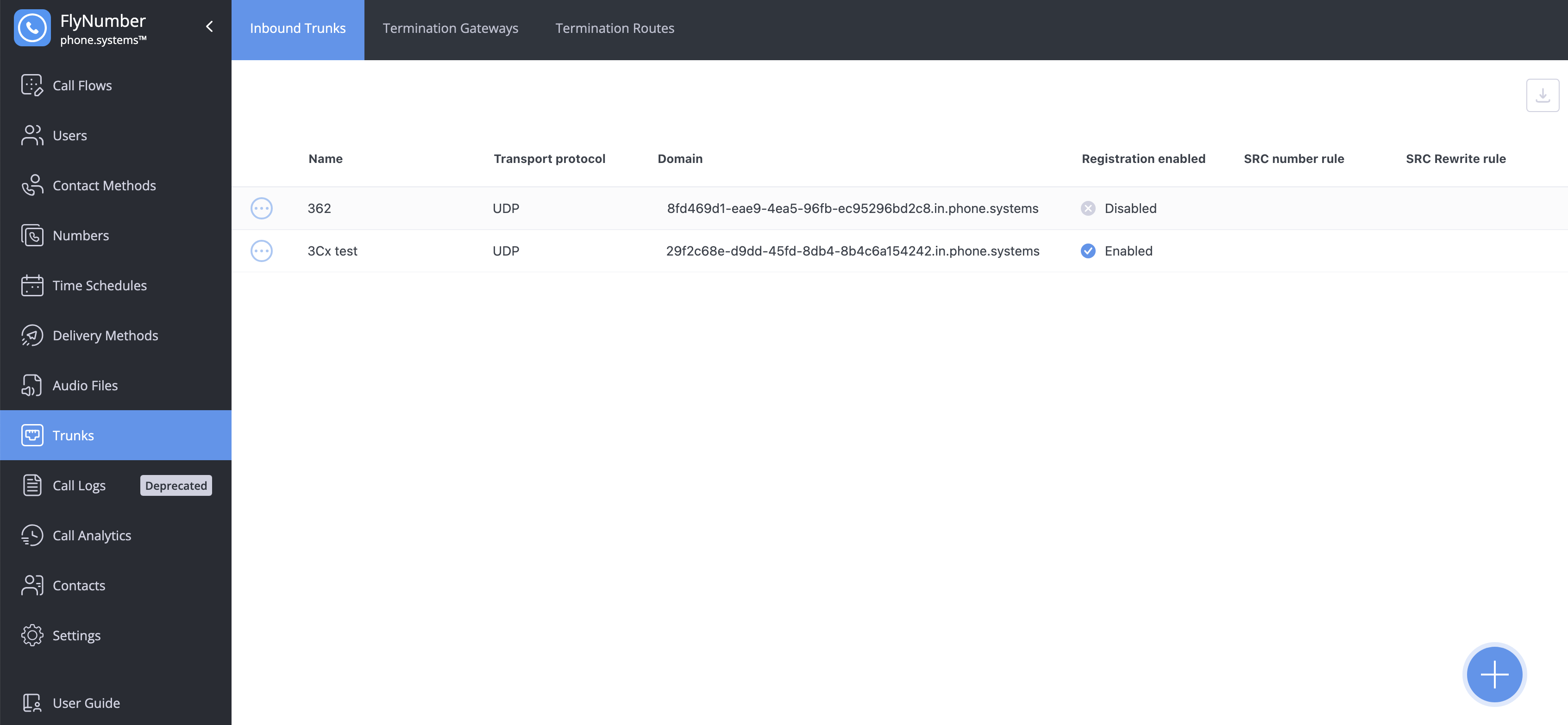

Hi FlyNumbers team,

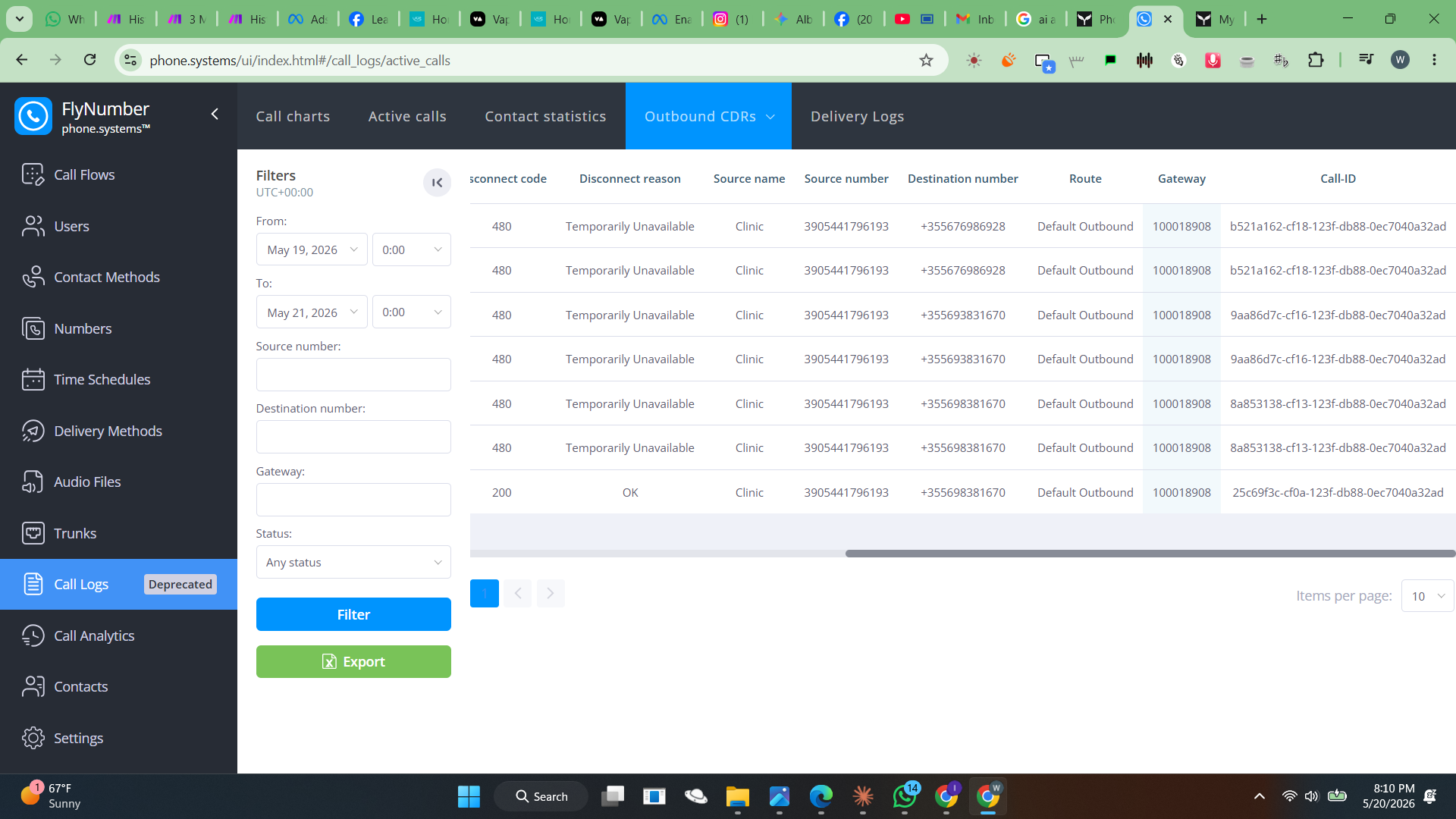

Following up on my setup — inbound calls are now working great with VAPI. However I’m running into an issue with outbound calls.
When VAPI tries to place outbound calls through my FlyNumber, phone.systems returns 480 Temporarily Unavailable and the Route shows as “-” in the call logs.
Looking at my phone.systems dashboard, I don’t see an “Outbound Trunks” section. Is outbound voice termination available on FlyNumber accounts? If yes, how do I enable it?
Thanks
Hi @DomenikoHibroj,
It is enabled and it shows up as “Termination gateways” and “termination routes.”
You might want to look into the route as the call logs (you can also see this within the phone system) are failing because of the + sign being used to call out. Can you try to have Vapi call out without the +, or edit the termination route to strip the +?
Thanks and let me know.
